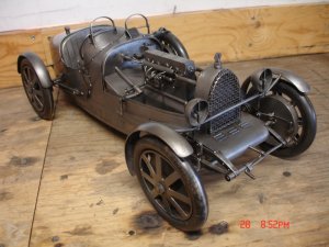

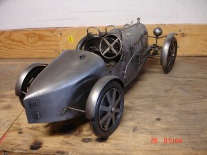

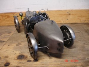

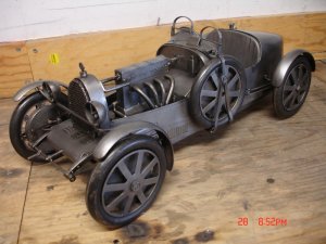

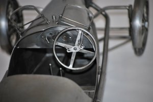

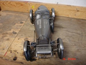

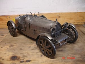

My impression of a Type 37 Bugatti, .045 cold rolled steel, various diameters of welding wire and cold rolled rod.
Jim

Incredible, absolutely incredible! If you ever wanted to sullen your hands with a paper version, the website below has a collection of the nicest ones in paper, maybe even plastic, depending on who builds it, I have ever seen.

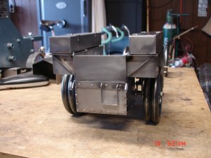

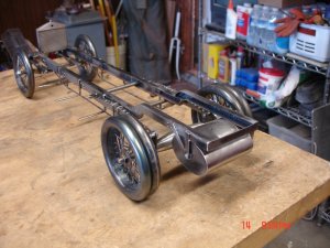

Did I tell you guys these large projects take forever. I had a lot of interuptions last fall and didn't work on the RR AC for quite a while, I'm setting it aside for a while to focus on three motorcycles. I'll post them as they progress.
The Rolls to date
Jim

You must have incredibly strong hands, arms and neck. This kind of work is hard!!! :)

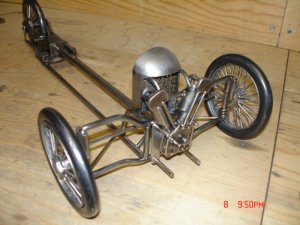

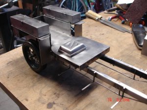

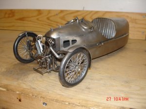

Wrong!, .045 cold rolled moves quite easily, its all technique and leverage:thumb: . The hard part is not welding your self into a corner, I hate cutting things apart :cry: These projects are nothing more than elaborate puzzles that happen to look like something .
Decades ago a very skilled Tig welder taught me how to "work smart not hard" save your body.
My version of a Morgan Trike, mid to late 20's
Jim.

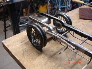

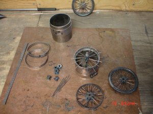

I probably told you guys I'm setting the RR AC aside for a while to concentrate on a few motorcycles. For the next few days I'm in wheel building mode, this is how you can do this without a lathe, I have a air eraser, an airbrush that shoots fine grit instead of paint to clean up the oxide on welded parts.
Jim

Welding wise, I use a Miller Maxstar 150. Its 120 volt DC only, since most of what I do is in the 30 to 50 AMP range its just fine. With the low amperage I'm used to, you can do a quick tack about a 1/2" from where you're holding the metal
Most of my tungsten is 1/16", I cut the 7" tungsten in half using the medium wheel on my bench grinder, grind a point on each end then do a fine polish on the 1/42" belt sander, I uasuly prep 2 or 3 tungstens at a time that way when I dip the tungsten or touch it with filler wire I have a new one handy. You will contiminate your tungstens.
The other tool that I must have is a 25" 18ga. max bench shear, I'v used Beverly shears, tin snips and aircraft shears all my life, but nothing can cut a crisp straight edge like a shear.
If you have two pieces of sheetmetal with a clean metal to metal edge you can do a series of small tacks and the joint will dissapear, no need for a full length weld.
I drill very few holes, most of the holes I need are done with a Whitney Junior punch. The holes in the RR AC turret are a series of punched holes and a file is used to connect them. The strip of metal in the photo with all the holes is a template for rims, I clamp it to another strip and punch the spoke holes, I'll do a photo of the wire wheel building process in a day or so.
We'll continue this in a day or so.
Jim

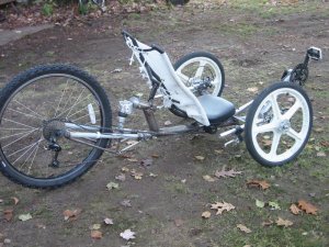

I ride this trike around that I used a mig and tig on. I also ave done many cat floor installations and quarter panel repairs. The trike is not a model. I machined all the shock mounts for the rear suspension and machined the hubs for the front wheels and disc brake mounts. Everything was fabricated, except for the obvious parts.
