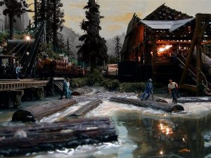

Hi Ian,
I always use High Gloss Yacht Varnish for all my lakes & Ponds, brushes on quite well and after a few coats looks deep. My base colours are mainly Black with a feathered edge of light brown/green. then as it starts to dry I dry brush other dark colours into to it.
Shamus

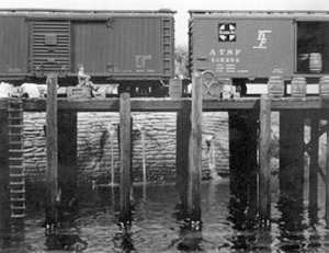

Ian, if you use Enviro-Tex, you can tint it with Floquil paint. (I'm not sure if Polly works also; I've never tried it.) Just mix a few drops right in.
But be forewarned: a little (few drops!!) goes a long way. Too much paint and you wil have a very murky-looking mess.
You can also use gloss medium to create the appearance of ripples and waves. It's fairly easy to work with.
The photo below is of a scene I created many years ago. The water is Enviro-Tex (untinted) poured over a flat-black base. The waves/ripples were created with gloss medium over the Enviro-Tex after it had thoroughly dried.

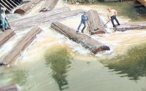

Hi Walt, Got to admit that these people are just Model Power plastic folk with poles added to the hands. I tend to mold the little people (Heat them up in hot water first) then I can put them in various shapes. By the way, they ALL LIKE THE WATER. :D
Talking of water, here's another look at the pond.
Shamus

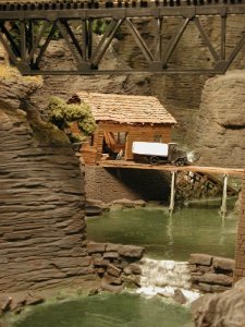

acrillic water
acrylic artists paint, and lots and lots of coats of acrylic gloss medium works like a charm, acrylic modeling compound does well to shape waves , waterfalls ext,
in my example the water is plaster, painted to color, and lots and lots of acryilic gloss medium (varnish). it looks real good. the varnish dull out over time, so a coat of varnish once a year or so keeps it fresh.
I avoid the epoxy method, as it has to be done in a one shot deal, and if something isn't just right, you have to live with it or tear it out and start over. with this method I can work over and over in the same area until I'm satisfied. here is a shot of some water way up Perry's Gizzard on thebig south fork of Crooked Creek.

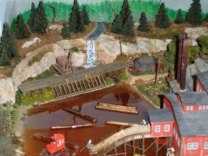

Here is a picture of my pond. I made it with Magic Water

Magic Water
Yes it is like Envirotex. I have used both, and I prefer magic water it is thiner product and pours nice.
Check out there web site for lots of info. www.unrealdetails.com
Especially developed for model railroaders.
