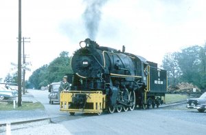

Hey Bob, I think I found a picture of you in the Army, doing what you love to do. (Didn't you say you made an Intelligent choice when in the army, or where you talking about the chicken-bone readers? :D) You're the one hanging on in front, right?

Hey BDC, you blew my cover!!!
Where in the world did you find that picture? I see the rear end of a '55 Chevy on the right and a '57 on the left. The fatigue hats ( our "Castro" hats) date the pix a bit too. Even as old as I am I can't recall seeing an Army steam engine that was operational. If the pix isn't from there at Ft. Sill I would have to think it muct be at Ft. Eustis, VA at the Army Transportation School.
Would love to see that 2-8-0 Consolidation come steaming into town about now:D

Not sure where I got the picture from, and I'm also not sure where the photo was taken either. Sure wouldn't mind seeing that engine come to town either...
Actually, I don't think it was Ft Sill, mainly because we have 6 RR crossings here (I'm stationed at Silly [sic]) and all of them are 90 degree crossings. Also, if it was Sill, there would be several buildings visible that definetley pre-date this photo. Must have been Ft Useless [sic again].:p

A big thanks for posting the photo. I am a real steam buff so like it. The hardtop 57 Chevy was my favourite at the time too. What a car. Big V8 and wheel covers at the rear. Great for Saturday night cruising.
