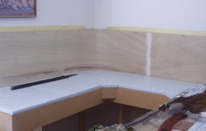

I might add to what the others are saying in that I think the vinyl flooring is going to have a tendency to tear easily, not good in a move. I just finished putting up a backdrop and used a sheet of 1/8" lauan plywood. I cut it in half and to 16' of 24" backdrop. I wanted a radius in the corner, and had problems with it trying to split until I soaked it with a hose for a minute or so and it bent just fine while it was wet. Home Depot sells the lauan for about $11.

Masonite is great for backdrops and is fairly inexpensive as well. You can indeed get some tight corners using that method. I did basically the same using the lauan plywood. I soaked the center with a hose and just shoved it into the corner until I got the radius I wanted, then put a few screws in to hold it in place until it dried. Here are the results before I painted it.
