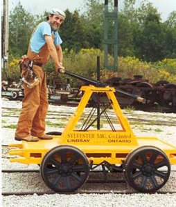

hand Trolley
Here is the Hand trolley as promised the guy on it is one of the volunteers working for the Radial Railway which preserves and runs Street cars In Onterio, Canada he was working on the tracks nearby and agreed to pose for me. I have some nice pictures of their street cars which I will post if anyone is interested
