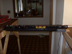

Extending the side boards to the other end would be perfect! I'm with Loren... if I didn't already have my lift-out done, I would do it like this.
60103
Pooh Bah
Mar 25, 2002
4,754
Brampton, Ontario, Canada
I wired my removable sections with killable sections about a yard (or a meter) long on both sides. I used phone plugs (1/4") at each end to carry the current (backup to the rail joiners) and they have to be disconnected to remove the section.
I wired the dead sections by gapping a different rail at each end (N on one side, S on the other) and having that section fed through the removable bit from the other end. This should protect any train with the loco at the front; can't protect against the person that backs a long train into the gap.

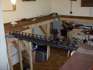

I like you basic design, Jim. I think I would make my roadbed from wood and start it about 6 inches back from the end of the bridge extending it to under the ends of the track on the bridge. Then at the end of the table where the bridge comes down, remove the cork so the rails will line up on a level plane. The wood roadbed would then protect the track and rails from any accidental damage.

I agree and do plan on making some changes. Just wanted to post the first version to show the advantages of locating the pivot away from the edge of the opening.

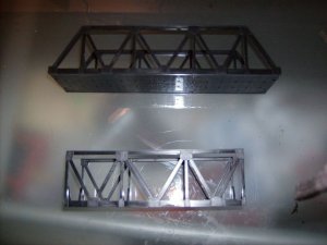

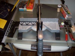

The first picture is what I started with and after I cut the ends off. It started out as a Atlas Warren Truss Bridge. I used 5 of them.
