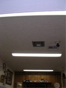

My Daylight Fluorescents are not Bulb's they are TUBES and are 5 feet long each one, and I have 9 on the ceiling. I have them wired so just one comes on for normal working when I need photography, a further 2 switches will bring in the others.
Here's what they look like.
Shamus

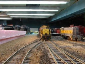

Gary Pfeil
May 7, 2001
2,510
Boonton NJ
Mike, I do pretty much as Shamus suggested, I space mine 2 feet apart. Drop celing panela are 2x4 so this works well. I find the lighting nice and even. Don't have the drop ceiling in place on this side of the layout so you can see their spacing.
