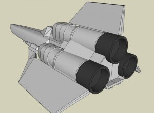

Concerning the Viper, I'm designing the thing as a series of modules which should unfold fine. The reason for that is that some elements are supposed to become parts of other Viper models. The base of the Mk. I is going to become the base of the Antique Viper and the Scarlet Viper. So you may expect several recurring pictures and build steps in the assembly instructions.

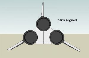

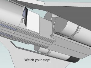

I have aligned the parts to make the Viper symmetrical (aft view).

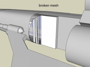

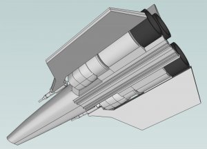

Then I cut off a section in front of the intakes to make the aft part of the nose slimmer. Big felgercarb! The mesh broke and was beyond repair! wall1
Furthermore I realized that the plans I used were not symmetrical which led to a step at the bottom. This was an easy fix, but the broken mesh kept me busy for two hours! :curse::curse::curse:
I finally restored the model (thank the Lords I had saved it before), used a new shape for cutting and changed the cutting position. Even then a few faces disappeared but he mesh could be healed within five minutes. Phew! :p
Next will be the wings and the guns.

Even with the problems that you had, it is still coming together very well.
It looks like the Lords of Kobal were indeed smiling upon you.

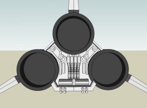

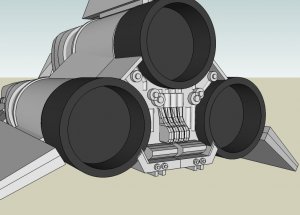

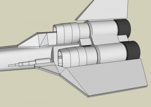

Here are some of the first greeblies. I've begun with the rear section. The shape of them is partially preliminary and will be updated on-the-fly. The flat ones serve only for display purposes. They will be redrawn as soon as the texture is applied. Later they will be exported as flat pieces which are laminated to cardboard before they are attached to the surface.
The greeblies on the surfaces between the engines will be made in the same way because they are all flat. I'm thinking of using real wires for the wire greeblies on the tubes behind the intakes and supplying optional paper parts in the final plans. This will give the model more depth and the areas will even look better than they do on the Revellogram model.

This is realy starting to look fantastic.
If you go on like this your Viper will look tons better then the Revellogram.
As I remember it was an okay model, but with the greeble options you can put on this one it will be far better.
I'm looking forward to see more and am extremely anctious to see the textures placed.
Take your time though, I know the wait will be worth it !!
