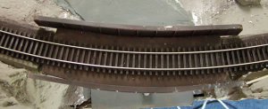

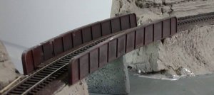

Mason - that bridge has replaced the match-stick trestle (thanks for remembering) for two reasons. 1. the trestle is nearly 3" tall - too tall for the grade, and 2. it wasn't compatable with my idea to run a street through that area. SO....
I snagged the two sides of the new bridge from my Son's el-cheapo LifeLike set we don't use any more. Since they were straight and the track curved, I had a dilemma. I solved it by drawing the shape of the curve on to a piece of 1/8" masonite and then cutting it out. Next I attached each side to the masonite using (of all things) staples and Elmer's. After everything dried I removed the excess staples and trimmed those that had to stay, sprayed it with a little flat brown paint, ran a sanding pad over it for fun and, voila! A curved bridge for about 17 cents. The abutment holding it up is a piece of foam sanded to shape and painted gray - probably needs more sanding.
here's a closer look....

Cool...
Thanks for the additional pictures. I have two (2!) places where I will require curved bridges - both on a grade too! Such are the limits of the 4x8 I guess.
I will have to check for "garage sale" bridges that I can slice up - have never seen anything as cheap as $0.17 though... ;)

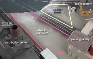

NOW - here are a few questions posed vis the attached picture.
1) How can I get some fake water into my water tanks on the roof? It seems like it should be simple, but I'm not getting it.
2) What would you suggest I put in the large, open area behind the packing facility? Lots of room there and I would like a bit more than just an open, grassy area.
