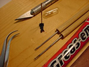

Charlie, don't know if my method with those springs will help you, but I will try and describe it. If your coupler is one of those with a two part case, insert a drill or pin into a piece of wood to hold the case. Insert the case onto the pin thus holding it in place. I pick the spring up on the end of an exacto blade, #11 works best. Pick the spring up by slipping the blade down into a coil about half the length of the spring, gently of course. Place the spring into the case one end first, - then gingerly push the blade to compress the spring back enough to fit into the case. Push the spring off the blade with a probe. It should stay in place without going "ping". I made up several types of probes by using 1/4 dowels and heavy sewing needles. My favorites are the large canvas needles where I broke of 1/2 the eye. This gives you a little fork like probe.

Those are some pretty nifty tools you've made for yourself!
Well, I FINALLY got one of those things together last night! I did exactly (well...almost) what you described, Bill. I picked up the spring with the x-acto blade, put it in position, & then put my finger over it, & pulled out the blade, & much to my astonishment, the thing was in there perfectly! The night before, I was trying to use tweezers, & & "pinged" 3 or 4 of those little springs into the wild blue yonder! I still haven't mounted the coupler yet, but that shouldn't be as big a problem. I installed them on my GP7 with no problem at all.
