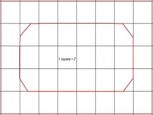

thanks guys for the response. i will attempt to describe in this reply what type of layout i want. i have read through a lot of books on track design, plus the big book of model railroad track plans. if it would help, i could post a scale diagram of my bench work, just let me know. ok, here it goes.........
i want a layout set in the appalachin mountains region where coal mines are serviced. i want the era to be around the transition from steam to disel era. i have a 90' turntable, walthers round house, walthers golden valley canning co., O.L. King & sons coal yard. i am planning on purchaseing another larger industry, but not sure what it will be, so if you have any suggestions, please let me know. i also have a few smaller industries such as a disel service facility, a 3 stall service garage, a coaling station, and a water tank. im open for suggestions as far as what structures to use. i want continuious running action with a switching yard. it dont really matter how many lines i have as long as one crosses the other, thats a must for me because it looks good. i plan on running older 4 and 6 axle disels such as GP30's SD's, coal cars, flats, bulk tankers, nothing big, maybe a 4-8-4 or two. i dont care for passenger cars too much, so i dont really want to run them. i would like to include a river or stream to cross also. as far as my yard, i would like the run through type. as of right now i dont have any steam engines, so the round house and turntable arent a big deal, might not even use them. the hills and mountains i want are the type seen in WV and Maryland. if i have forgotten anything, please let me know, as i have tried to include about everything i would like in a layout. as i mentioned earlier, i can post a diagram of my bench work if it would help. as always, i really appreciate all the help and suggestions from all of you. thanks!

ok guys, here is what i hope will be a picture of my bench work. thanks for looking and remember, all suggestions welcome.

There seems to be a foot of width missing from your sketch, could you clarify?
Have you considered any kind of peninsula coming out into the center?
Is ther 6' or 7' clear inside installed the benchwork now?
