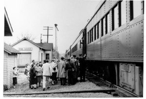

the real one
thanks Tyson! I hope this works.

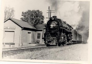

philip
the approaching end of passenger svc
notice the semaphore is missing....dang vandals

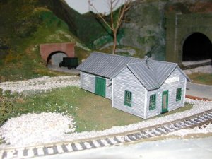

Nice looking structure phillip. What did you make it out of? One real benefit to scrachbuilding is being able to make a model of a real building even if it is just from a photo as you did.
P
philip
materials??

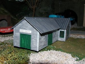

Robin, Here is the sort of "bill of materials". The whole thing is mostly evergreen plastic. The smoke jack is made of lead soldier. The screen door material is made out of one of those old wire mesh type coffee filters...that I stole from my wifes coffee maker. Actually I convinced her the filter was no longer serviceable...she has no idea I'm using the materials for screen doors LOL. The freight door are v-groove 0.25 spacing. The windows are Grandt Line. The doors are Grandt line 5 raised panel with the center cut out and the screen attached plus the 5 panel doors on the inside.
The roof is evergreen with that maddening little groove that you are forced to glue that tiny little strip in. The siding is clapboard .030 spacing. The frame is square tube for reinforcment.
The out side corners are angles like .060. I brush painted the siding with testors primer and then ruffed the finish with steel wool. The roof is testors battleship gray with the steel wool finish. The doors and windows are Polly Mec Pine green. My presentation of the thing is awful. I will some day plant all my models when my benchwork and track is laid. :) TAD... welcome!
