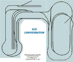

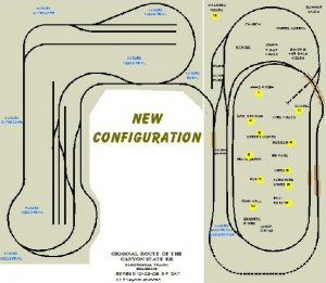

...so I tore my newest section almost all apart and redid it. Here are the old configuration that I had the track in place and wired, but not ballasted, and the new configuration where I'm almost back to that same point now. Just a bit more wiring to go and I'll be able to test the tracks.
There were several reasons for my making the change. My original layout (to the right of the white line in the sketches) is hinged. The older configuration had three crossovers between the newer, fixed side, and the hinged side and I just couldn't keep all three sets of tracks aligned both vertically and horizontally. I'd get one track set, and the other two wouldn't line up. Secondly, the only way I could run a train in the new section was to have it cross over into the original section. I redesigned the fixed section so that I can run a train there in a loop and still loop another one on the original section without having to worry about either one. :thumb: I also got rid of that pesky reversing loop.
Anyway, I'm happier now. I've got a smaller yard, but more room for industries which pleases me since I enjoy building structures and scenery more than running trains anyway.:D

The problem is that the older section is hinged and that's the only way I have access to my wiring. It was a good idea at the time, but now I'm stuck with it. I've also got some storage space under there for long things like track and roadbed. When I swing it closed, somehow I could never get all three sets of tracks to line back up. Now I only have to be concerned about one set.:thumb:
Good luck on your remodeling project. Ya gotta make room for a layout somewhere.:D

Other than all the reverse loops, I like the original. I think you should add a connection at the top, so you can make a loop out of both sides together too. Does look cool though. What is the overall size?

The "L" section is 4.5' x 6', the hinged section is 3' x 7'. This is, of course, N scale.:D

I agree that you should add at least 1 more connection between the two as once you enter a loop, the only way to the other is to back up.

Don, I was going to suggest as other have done, that you add a second track between the 2 sections of layout so that you don't have to back out of the right section to get back to the left section of the layout, but then I reread your thread and noticed that you are trying to eliminate all but one track at the joint for reliability. I noticed that you don't have any reverse loops. One reverse loop on each side of the layout would allow you to move from one side to the other and back freely without having to make awkward backing moves to do it.

Russ, I'm aware of that. I had a reverse loop on my original concept and had too many tracks between the two. What I achieved is two loops, one on each side of the layout and I may never run trains between the two. I have one place I can add a "Y" and create a reverse loop and still maintain a single track between the two if I want to. It isn't too late to change it, all I need is the incentive and two more turnouts.:rolleyes: :rolleyes:
