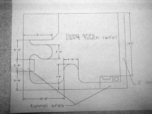

This my first thread and I would like to know what you think should be included in the space I have. I am going to use HO scale. I would like to know where you think a good place for the steam era service terminal should be. I have started building a 15 stall roundhouse, the rest is to be determine once I do more research on what was in the city I live. Garrett used to be and still is a division point for the B&O (CSX). I hope the layout shows up.

If I am reading your drawing correctly, you will need to put some sort of access hatch in the upper left corner where the bench work appears to be over 6 feet wide. There is no way you are going to be able to reach back into that corner without an access hatch.

I have received some very good advice from others. The number one item seems to be use the largest radius possible - everywhere! If you are having a loop in the 4' wide section (middle of the bottom) even with a 3" space from the center of the track to the edge you only get 21" radius. Most have not recommended less than 3" where possible. Can this be a little wider?
...Jim

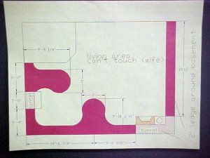

I took the advice given and redesigned the layout. Anymore suggestions are welcome.

A peninsula 4'6" wide will allow 24" or 25" radius, and that's on the outer track if there's more than one. If you're modelling steam-era, I would try to get a little larger radius.
