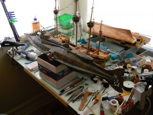

After building plastic and wood ship models for many years I decided to try my hand at paper modeling. This model of the Nautilus as depicted in Disney's "20,000 Leagues Under the Sea" is my first attempt at paper and I added a lot of additional detail from parts that I cobbled from many places. Enjoyed building this so much that I ordered Taschen Titanic, Halinski Scharnhorst and many others. Now I just have to find time to build them.

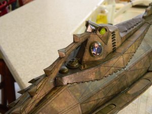

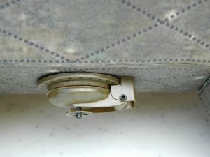

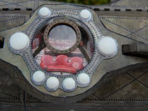

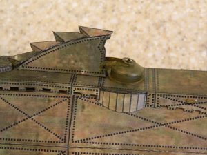

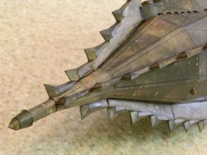

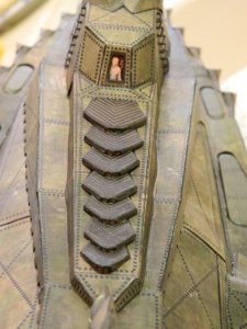

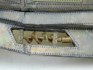

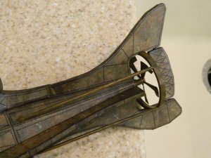

For those who are interested, here is a little more info. The hatches were made from wood buttons with hinges made of paper and dowel pieces. The conning tower windows were made from dolls eyes bought in a craft store - cut out the back remove the "eye" and you are left with a nice clear dome shape (you can buy a bag of various sizes for a couple of bucks). The large side viewing windows were the most challenging. I finally got some inspiration when I bought some lightbulbs for the house in a blister pack. The shape was close but too small, so off I went to Home Depot to look at things in blister packs when, lo and behold, I found the perfect size and shape in a toilet bowl flapper valve (amazing the sources for modeling materials). Another interesting item is the spiral speed log. This I made from a piece of spiral macoroni. The original macoroni had two spirals so I cut one spiral off with a dremel tool. The prop shroud was made from PVC pipe. Other deck hardware came from kit pieces that I had lying around.
If you look through the windows you can see Captain Nemo and the interior of the grand salon. These came from ensmallments that I made from movie stills and glued them behind the windows.

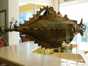

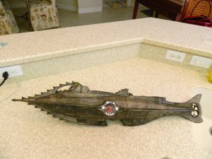

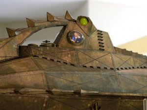

The model is 36 inches long and was made from 60lb cardstock reinforced wbalsa wood. After coating with clear matte finish it seems very sturdy and shows no signs of warping even in the humid climate we have here in Florida.
I must say that I really enjoy reading the info in this forum and have learned a lot from all those who have posted their experiences here.
Also I would like to thank you all for the kind words. They provide much need encouragement.
You can see on my workbench that there are several projects in various stages of completion. There is Nautilus, a Spanish galleon, and the hull of a revenue cutter.
Edges of the paper was colored with marker pens. Additional rivets were put on parts that I added with black markers. The finished model was coated with four coats of Testors satin finish clear coat (clear parts were masked during the final coats.
I'm working on a display stand for it. Found four nice nautilus shells at a shell store and was thinking of supporting the model between the four of them on a display base board.
