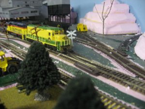

Awesome photos everyone!!!:thumb: It's been a while so I thought throw one in the mix. Here we have the Straitsville turn stopping to switch the very busy Monday Creek #4 mine on it's way back to Nelsonville, Ohio. One of the mine workers climbed on his rooftop to capture the leased Reading unit on the point.
