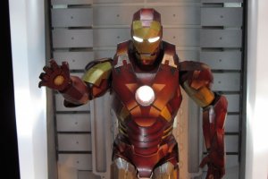

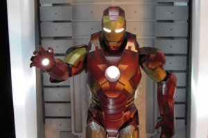

Hi, today I finished my Iron Man model. It is a free model from Paper Replika. I also planing to build a diorama for the model. The model is build with some extras, the eyes and the ark-reactor are illuminated with LEds. Seperatly the right hand-weapon is also Illuminated. The LEDs I used are very powerfull, so I had use som bigger resistors, I will test it in the next days. So here are some first Pics
regards Loenf

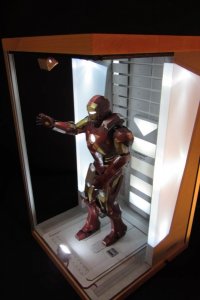

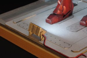

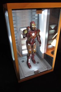

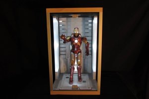

Diorama Iron Man MK VII

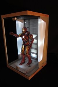

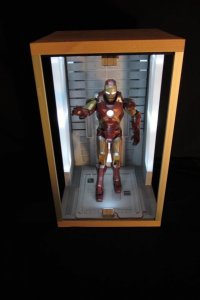

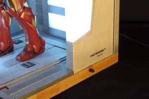

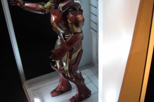

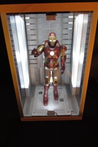

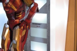

Hi,
some things will last a little bit longer than expected. Today I finished my Iron Man diorama. It tooks a little bit longer to figure out the right brightness and position of all that LED's I used (about 16). The whole Diorama (except the case) is made of cardboard. I used a switch on the right base, so the eyes and the repulsor hand can be switched on and off. All the LED's I used are ordinary 3mm white colour. To adjust the right brightness I used different resitors. The powersupply for the diorama is an old charger from a mobile phone with 5V DC. Here are the pictures of my first Diorama in 2013:
regards loenf
irondio1.jpg irondio2.jpg irondio3.jpg irondio4.jpg irondio5.jpg irondio6.jpg

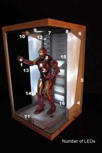

How many LED's did you use ?. If my counting is correct, there must be 11 LED's integrated in your base, am i correct ?:confused:
Could you tell the value of your Resistors ?.
Anyway, an awesome build, well done.
I hope i can get mine to that standard too.
Greetings from greece :wave:
Hi,
all in all I use 16 LED's. I count them on the photo below. I used different resitors, from 100Ω for very bright light like the spots in the front, to 450Ω for the background lights. One short tipp: if you want to make your model optically opaque, use self-adhesive aluminium foile for the parts which shouldn't be translucent.
regards Loenf

LED's used
Thank you Loenf for the info and the detailed Picture.
I see now where i missed the two LED's in my count.
I still have a lot of work till i get to that Point with the LED's.
