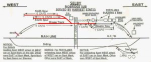

The Inglenook track configuration is quite common in the prototype world, and there are examples on the web site Dwight posted for many nations, including the US. After all, 2 spurs coming off a main line, or a 3 track yard with lead, is hardly uncommon. What is uncommon in the prototype world are tracks with that little capacity. But we all have tracks with less capacity than the prototype. Here is an example of the Inglenook configuration in a prototype LDE at Selby, SD - the Inglenook portion is marked in red.
The key to the Inglenook game is the capacities in number of cars of the 3 tracks. There are 5:3:3 Inglenooks, as well as smaller versions. The number of possible combinations for the game decreases when you decrease the capacities of the 3 tracks.
But you can have the tracks with much larger capacities, and artificially limit the track used when you decide to play the game. In the meantime, you use the layout normally.
