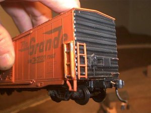

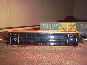

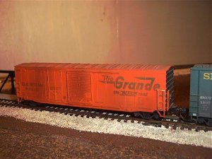

Although not as detailed as the Doc's, I have a roster of all my locos and rolling stock.
I have tracked down all the manufacturers stock numbers for all but a few.
There are clues to the manufacturer, How the car is assembled, what material it is made of, the way the trucks and couplers are mounted (assuming they are original), the road and road number.
If you can't identify the manufacturer after checking catalogs and magazines post a photo of it I'm sure someone here can Identify it.
There are some tough ones to figure out if you don't get them in a marked box.
One I got was a Life/Like shell with a Details West chassis with Athearn trucks. It was sold that way in a kit by Bev/Bel.
Here's one I am not sure of.

Ray, that car also looks like it has a Details West underframe. Any chance the carbody is from Robin's Rails? I had a Great Northern car that looked similar to yours, although the underbody was different.
Other guesses would be McKean or Front Range.
Wayne
