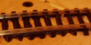

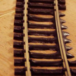

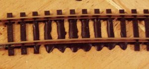

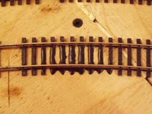

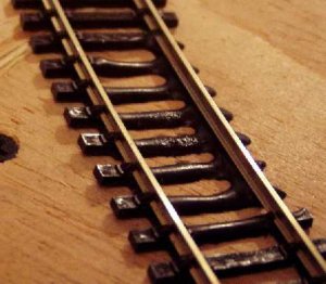

I wondered if this has happened to anyone else the pictures tell the story.
I worked down stairs today , and that is when I noticed it, there are no tell tale marks as to why this happened the rail shows no heat marks from outside interference :eek:
The track has had no permanet power to it only today I wired it up and ran a train that let me know the track was slightly out of gauge.
Any ideas? :cool: :cool: :cool: :cool: :cool: :cool: :cool: :D

odd. any heat source at all nearby - furnace vent, etc? Or chemical melting - acetone or paint thinner will do that.

I would think that if the track oveheated because of a short, it would melt the ties a lot different. I agree, this looks like a chemical burn like acetone or laquer thinner. Direct heat would have to be very close and very hot to do this.
Any change of sabatoge or someone playing a prank on you?
Marxed
how old is the track... and how long did it take to melt?
if you sat a lamp or spotlight next to it... the heat from that would do it...
given the melt i can almost visualize the location of the source if it was heat related... soo i wouldnt be suprized if it was a lamp or lighting device... or maybe it was near a hot water pipe... winter is coming around and it's the season for heaters to be turned on

CavlrZ and Gary, hit the nail on the head
I remembered after posting this that I had a trouble lamp with me last week and put it down on the track.
