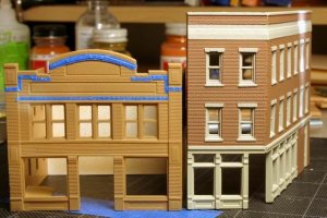

Finally I was able to achieve nice sharp lines when painting a building with my airbrush.
I read somewhere here on The Gauge how to avoid paint running under the masking tape by first painting another coat of paint on top of the masked building with the same color as the wall color, that way it will 'seal' the masking. And it works (of course it works, I read it here :) )
I am happy with the building on the right, and don't want to touch the windows, even though they should have another color than the sill, but I don't want to mess it up with my clumsy hand painting. (I have several other buildings which are hand painted, and I'm not happy with them)
After the 'success' with the first building, I went on to the next building, but now I was wondering if somehow it's possible to also airbrush the windows, in other words, once I'm done painting the trim, should I then mask off the trim and give it one more coat trim color and then paint the windows, or what is the best way, or do I 'have to' hand paint the windows?
Thanks

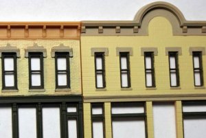

the problem is that I like clear sharp lines, and I don't seem to be able to get that when hand painting e.g. the windows or the trim. This picture is an example of 2 hand painted walls.
The right one is one of the better ones, but still I would like to have had a nice sharp line
between the wall and the windows. The wall was airbrushed and the rest hand painted.
The left one is all hand painted, and definitely it will be repainted with the airbrush.

belg, maybe it's hard to tell because the color is so close to the unpainted color of the plastic, but the left building (first picture) has already been painted dirt color, I will then mask of all but the trim, then paint it all dirt color again, to seal the mask, and then paint the trim in a light gray color. Now my question is how/when should I mask off the rest except for the windows to get this nice sharp line?.
