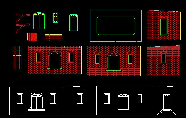

I've got the lenght and widht of the building out of the originial trackplan. Next was a long day on my PC to draw the parts of this building in CAD.

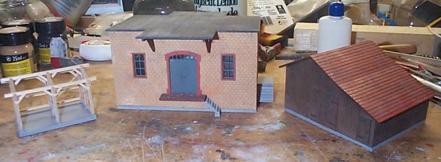

I've milled the walls out of 3mm styrene sheets. All bricks are engraved before. At the same time, the doors and windows have been milled on my small machine out of 2mm styrene. After assembling and coloring, the model is nearly finished and cann be placed on the new layout tomorrow.
You can also see a barn on the right and an other small shed in the left.
