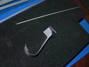

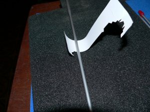

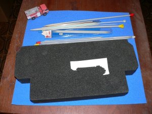

Hello,
here are some pictures with an example for using foamed material and a needle to curl paper. Another modeler explained it to me at an exhibition.
Kind regards
Markus Schweizer
