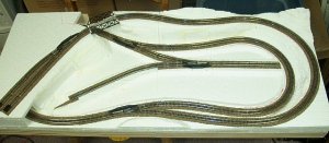

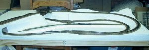

I will second SD90's suggestion for contact cement. I however used a different product that makes it go a little quicker but it is probably more expensive in the long run.
Hit the local craft store and look a product called UHU Creativ'. It comes in a tube and they have different versions for different applications but the product I use is foam safe. I have been using this to assemble flat panel foam RC aircraft for a while now and decided to try it on the trains. I am making a small display layout out of some left over sheet foam that I had from some packing.
I used it for both the cork road bed and the track laying. It allowed me to lay the cork and roadbed in as small as 6" radius with no pins, or tacks to hold things in place. Everything else I have tried required pins and weights to especially on the roadbed to keep things flat while the glue dried.
Spread a thin layer of clue on both surfaces, the thiner the better, it will cure quicker. Either allow to set for about 5 minutes or you can speed things along with a hair drier. Start at one end and start laying the track. It seems I could get smoother corners and transitions in both the track and the roadbed using this method.
The first picture is one evenings worth of work. The second two are after the second evenings worth of work. The contact glue makes thing go together fast although I am now using white glue on the rest of the foam landscaping just because of the amount needed.

Nice little display layout, I'd like to see some more photos as you go along...
skipgear
May 15, 2005
55
extra7000 - Thanks. It is mainly something to build for experimenting and learning different techniques before I start on my primary layout. I am building this to fit in a display case at the hobbyshop that I work part time at. It is in two modules that will bolt together so it is easier to get in through the doors of the case. Size is 17" x 42". Min radius is about 6.25 so I am limited in what I can run on it but the little 0-6-0 in the first picture makes it around nicely. I have to stay with 33-40' cars which fits in fine with the steam era equipment that I have. Also tested an older atlas/rivarossi 4-6-2 pacific and it ran around fine.
