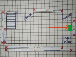

Russ, I've lived in this house for over 3 yrs and have only needed to get back there once. so it would be very rarely. The water main cut-off is back there and water meter. however I can tell you that 15" is the most anything back there is away from the wall.
I was thinking in terms of having a cart or removable section run around that corner in front of the pipes and valves. If you need access, just disconnect the section and move it out of the way.

Here's another thought. Put some elbows in your water line just below the ceiling. Move it as close to the wall as the meter will allow. Move the meter well above the layout, and angle it so you (they) can see it easily. Make sure you can reach the cutoff easily. Chop the pipe going into the wall and add a couple of more elbows. Lose the wall, lose the closet, and you've got yourself a train room.
Get permits and hire a plumber to ensure it's done right. No one will object if your meter is close to the ceiling as long as it is visible. No one will object to moving the shutoff valve as long as you can reach it readily (in an emergency). It will cost a few bucks, as much as one or maybe two locomotives, but you'll have a train room!

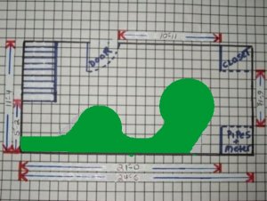

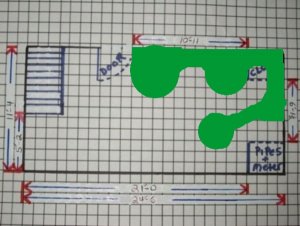

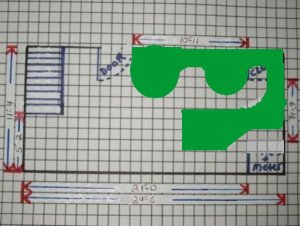

Thanks Scott and Galen for the great ideas. the thought never really occurred to me to move or change meter/valve. I don't think My BOSS would go for that. I can hear it now, "I thought you just wanted to put some trains in the basement and now you want to GUT it"! Spoken with love of course. But I'll float it by her and try to "bribery". Galen, before you posted I was trying different things, trying to keep access to everything, here's what I came up with, tell me what you think...anybody...

Nazgul, all of the last three revisions show some promise. One thing you might consider is offering to use the area under the table for toy/game storage. This would allow you to remove the closet. Even if you go with one of the first two revisions, removing the closet will improve the useability of the room.

3 plans
Okay...
the first pic, I like it alot. Seems to be a good use of the space, and the allotment you've left for getting between the layout and closet is tight, but passable. Just keep in mind what you might want to put there. Simple and scenic may be best, since any industry (or complex trackwork) that's a pain to access won't ever get serviced.
next pic seems simple enough, but unless shared space is a huge concern, go with the first one over this one. The extra mainline you get from the first one will be worth it since you can include a straight section between turnback curves to avoid a sharp continuous s-curve. Unless, of course, you're going with an up-and-over or figure eight or some other configuration with reverse loops, where straight trackage is built in. But in the case of the up-and-over, you'd still want as much room as you can get to reduce grades (unless you're sticking with short trains and/or geared locos, or double headers/helpers)
plan 3...pretty cool, just offer that long wall as a place for some nice shelving/storage units (and the air hockey?) as incentive and a way to placate the closet demo. Now the long blob sticking out into the room, I'd do away with the round end and just make it a long branch. And I'd push it as far into the room as I can go, at least as far as the door. Run it a branch line out to a mine, or to a little town with a timesaver built in. Use access from both sides as an opportunity to really detail some fun scenes. OR, make it a yard/terminal for staging the trains that will run around the layout. Just incorporate a way to turn locos - perhaps the simplest will be a wye leading into the yard. I wouldn't make it a major passenger terminal, since the curves you've got available don't lend themselves to long passenger equipment.
Okay, keep the good creative juices flowing! Just don't get analysis paralysis! Pick a good plan after you've narrowed them down, set a timetable and build it! Like someone said on another thread, benchwork is cheap (compared to the rest we need to build our miniature worlds).
Galen
Yes, I'm with #3, but extend the peninsulas out as far as possible instead of having the yard extend out into the room. More room for extended scenery and elevation changes, if desired. Loco direction can always be changed using a crossover, which is less proto as far as operations go, I think, but easier to incorporate into the layout.
I also like #1, which is basically your original idea, but #3 seems like you have better use of the stairs end of the room.

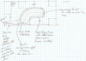

After careful consideration, weighing all the pros and cons, I've "decided of my own free will" to choose......my WIFE'S idea

I think #2 will give you a nice layout space and atill leave you some good space for the TV ( with room to sit back and watch it).

Gentlemen, I've learned more in the last few days then I have in a long time. Not just about model railroading but also about compromise. It is a difficult balancing act between what I would like and what the family needs. I am not at home at the moment so I can't post a picture of the (final??) bench plan but I will do so later this afternoon. In essence it is an abbreviated version of #3 that will allow for future expansion as the room becomes less playroom and more trainroom in the comming years. It is also the largest practical bench plan I can have and still allow the room to be utilized for other family activities. I believe, in the long run, that will be a good thing and will allow me and the boys a better opportunity to get the plan going and see "results" sooner so their enthusiasim wont waiver. I will also attempt to answer the specific questions raised about height, era, steam/diesel,switching/continuous, ect. at that time.
So stay with me...I've got a feeling THAT was the "easy" part.sign1
