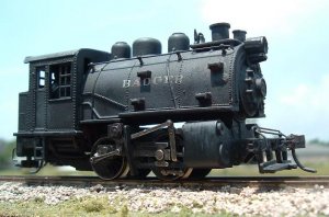

This Rivarossi Docksider was purchased on eBay for $18 and runs like a watch, I simply have no better switcher in my fleet. It has an oldtimey reversing headlight circuit from the 60s. However, the original owner felt it necessary to paint it with a turquoise and white cab :rolleyes: ---with bronze railings, steps and other fittings :eek: After doing a full clean, grease and lube, repairing the front pilot and adding wire details front and rear, I touched up the paint and weathered it, retaining the original owner's roadname.

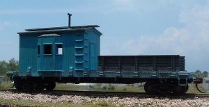

This boom tender is kibbled together from old Cox and Lindberg Line parts from the 60s. I bashed the roof walks from scraps of plastic and picket fencing, the stovepipe from a piece of sprue. The trucks have had their Talgo coupler boxes removed and their wheels replaced with MDC/Roundhouse ones, the Kadees are body mounted and the steps are made from brass ladder stock. Paint and weathering finished the job.

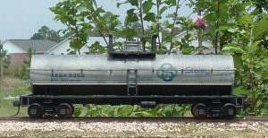

This oil can is an old Athearn with the original sprung trucks. The wheelsets are Kadees. I weathered it up and made new handrails for the dome walk.

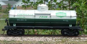

This is an old Life-Like issue from the early 70s. Its size and color were just too much to pass up. I filed down the steps to thin their profile a bit. Then I removed the truck mounted couplers and body mounted some Kadees, replaceing the wheelsets with MDC/Roundhouse. I use MDCs when others won't fit though I prefer metal wheelsets when at all possible. Some light weathering and off she goes...

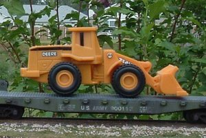

These loaders were purchased at Family Dollar, 2 of 4 that I bought for this very purpose. I changed the brakes of the AT&SF flat from a staff on the end to side mounted. I then body mounted Kadees on both then painted and weathered them. Still looking for two more flats, then I'll run these as a block togther for swiching around the club's port. For toys those loaders don't look too bad and, at $2 a pop, certainly good enough for me and my budget. :thumb:

Who makes those loaders? I have been to several Family Dollar stores and can't find them. I saw one in Boise Idaho but it looked way too big to be this one. I'd like to find a couple for a flat car load.

They're made by Ertl and they were right in the toy isle. I'll keep my eye peeled for a couple more when I go by there again.

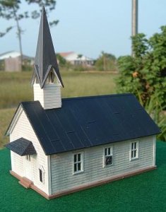

From the junkbox, revival has come to town with the new church I built. I don't know who made the base building but the steeple came from a Bachman N scale offering. The awning came from the scrap box as well, installed after filling in the holes provided for long gone details that never were originally installed.

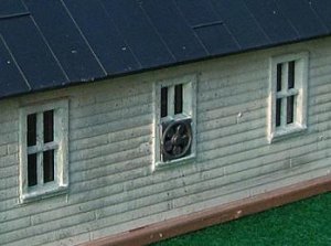

Deacon Stearnly Hardcase installed this here fan copped from a Revell engine house window for the benefit of his brethren and sisteren.

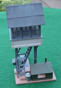

The shops needed a gatehouse when the fencing went up so B&MC management salvaged and repainted this early Revell offering from the late 50s. The decal was left intact as it was applied and carefully weathered around the 50 year old scratches in it. If you look in the door, you can still make out the awful original butterscotch colored plastic it came in.

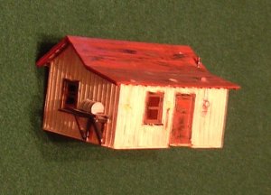

Another old Revell offering, reconfigured and repainted. As with most of my smaller buildings, this one was purchased already assembled in a box lot. I usually snip off unnecessary or unrealistic details, remove gobbed up glue then paint and weather. I usually fog over the windows with Dulcote in any building that has an easily seen interior like this one. Then I hard-wired all my Athearns. For newcomers, that would involve removing the upper motor contacter and then the upper motor clip, soldering wire to the clip and to each tab on the trucks and the bulb socket then replacing the upper clip. Best way to make a good horse better :thumb:
