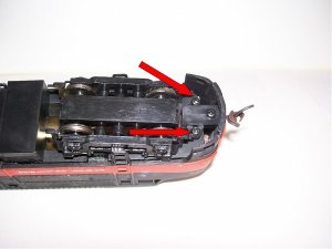

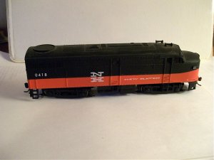

Just received my starter loco - it is a Walther's ALCO FA-1 Diesel. I was just wanting to open it up to see how much room there might be for a decoder, etc. Is there any easy way without breaking something?? I've attached a photo. Thank you for your help, Pat Patrick

I have an older one from about 10 years ago. with a smaller fuel tank. Mine has 4 screws on the frame near the tank that hold the frame to the shell. if you pry off the tank they may be there.

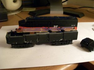

First, remove the coupler boxes. There's two screws on eachh side that hold the box in. The rear coupler is the same. Just remember the longer coupler box is the front.

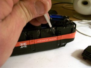

Next...remove the fuel tank. This is held by clips on the frame. Slight pry with a jewlers screwdriver should pop it right off.

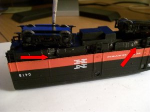

Next...theres four tabs, two on each side, that hold the glazing for the side porthole. Carefully pry on these, and at the same time lift the frame until the clips come undone from the frame.

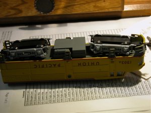

Now comes the hard part.
Carefully, at the point where the glazing clips are, lift the frame off the body. Its a good idea to alternate between the front and back, left and right side.You will get scratches on the frame, but thses will be hidden with the body back in place.
Take your time on this step.

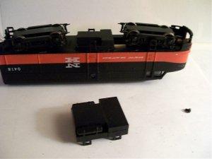

And there you have it!
Assembly is the reverse, except the body will slip right back on. Make sure you have the porthole glazing is in place.
