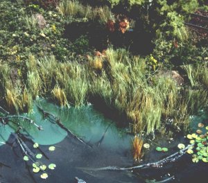

Can you believe this is a MODEL???!!!!! (Image from MRR online)

The problem that many of us have with modeling natural elements (rivers, trees, mountains, etc.) is that we "know" what they look like - after all, they've been around us all our lives. So we just make a model without really studying the prototype. And then it somehow "just doesn't look right".
I guess what I'm saying is look at a real river that's similar to what you want to model, or pictures of one. Study the colors, the surface patterns, the shape of its banks, the vegetation surrounding it, etc. And take notes!
