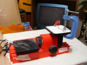

Did you see what I saw?
I have a table saw and a band saw, but my wife gets a bit upset when I drag them into the living room to cut some wood strips. So one day last winter we were at the Salvation Army scoping things out, and I came accross this saw for $5 bucks! So I had to buy a blade for it, I got me a scrole saw blade, and it also doubles as a lathe and a drill press. I don't use those much, but the saw and the sanding disk are just what I want for making stripwood stock. It dose cut pine a bit slow, but just flys through balsa wood. So keep your eyes open. You never know what you will find.
TrainClown

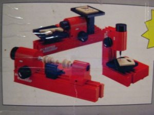

This is called "4 in 1 Master Workshop" and is copywrite 1991 by Natural Science Industries LTD. Far Rockaway, N.Y. I never was able to track down any parts or even another one of these, but they must be out there.
Here is the side of the box.
