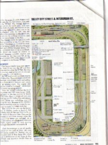

Now that we see the plan, there are some interesting considerations.
You won't be able to get inside the layout in N gauge; the aisles will be too narrow.
As an approx. 4x7 layout, you'll be viewing from the outside, and all the scenery will need re-jigging.
How much space can you swing? Keep the inside aisle as it is, but narrow the shelf width. Then you lengthen the runs and the sidings a bit.
(None of these comments apply if you're an anorexic supermodel.)
If you have extra space that you could move the layout into for emergency rerailing, you could build it on a single table 3'5" x 6' 8", and put it on rollers that would allow you to roll it out for access to the back if needed.

I'd be inclined to go the solid-top route with a divider down the middle, with a building disguising each end. With a max reach of 24", assuming you go for Russ's 4x7 suggestion, there is no problem. with working on it. You may also be able to add a couple more industrial sidings running into narrow alleys against tne backscene, increasing switching possibilities. It might even be possible to have the top end at a higher level and take a hidden track off the right-hand side, and feed around underneath to the left hand side, to give you continuous running when you wanted it
