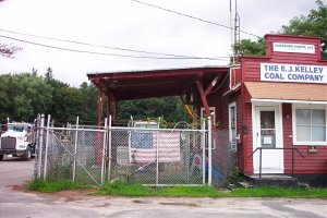

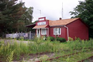

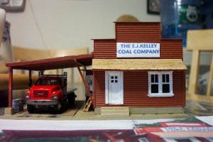

Here's the pics of the prototype. The secton with the bay window I figured was a later addition, so I didn't add it to the build.
Sorry, the "napkin" plans have been lost long ago.
