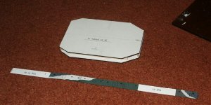

The kitchen is fully wall boarded and the first coat of paint is complete. I little more putty and sanding. No pictures of this stage.

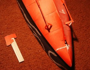

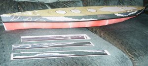

The Rodney is progressing.

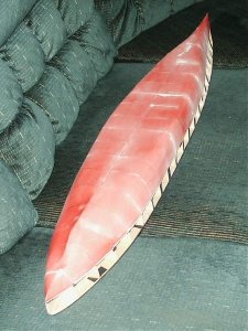

In the 1st photo I have started papering the hull. I used black card stock to cover all the formers, this has worked well. Photos 2-4 show the lower hull plated. Since I was was dry wall puttying and sanding so much I thought to use the dry wall putty on the hull. Much to my relief this worked very well to fill the voids and sanded easily with 600 grit wet/dry paper. I never filled a hull before (see my Porter and Paris photos for the best I can do without putty). The old Fly model is not computer generated and there is no way to paper the lower hull without gaps. In the past I used thin copy paper strips over the seams (see my Nagato and Portland models). The difference between these kits is the former are computer drawn while the later are older hand drawn kits. The last 2 pics show the 3 piece upper plating installed on the port side. The fit is remarkable and only required 40 minutes to install all 3.
Tomorrow I will finish the starboard side.
This comming weekend is a holiday in the US so the kitchen will get most of the effort, and during drying breaks I hope to get the shafts installed on Rodney.

Is that spackle or putty in the seams? If so, you can forgo the necessity and tedium of having to fill seams if you fill the spaces between bulkheads with styrofoam. My Hunley build thread describes how to do this. Though much smaller than your Rodney I learned this technique from the RC guys and have used it in much larger models to good effect.
Also, one of the things I have learned to do with ship models is to trim the bulkheads down a bit all around which ensures the color plates fit with a bit to spare; it's easier to trim than to add.
Hope this helps with future builds.

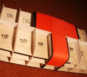

jkrenzer

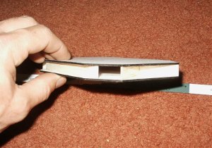

I started using balsa for only the main decks, it was much easier to cut and simply does not warp like heavy card stock. It was so much easier to cut and sand that I just started using it for the bulk heads as well. You have to be carefull glue the decks in place as white glue is still the best way to glue the paper to balsa. I pour the white glue into a small bowl the spread it with a 2 inch paint brush. The deck card stock is usually heavy enough not the stretch or bubble as the white glue tries to expand the paper. For the thin sheet bulk head patterns I use a glue stick that dries fast enough not to cause the paper to stretch. It just does not have the holding power so it tends to peel. I then just touch up the edges with CA. The entire frame is fitted then little by little I dab CA into the slots.
The nice adder is the model weight is much lower and handling is easier.
As far as the gaps, this is not so untypical of the older kits. Some guys make their own by laying grid paper over the bulk heads then tracing the needed shape. I time consuming process I will try someday.
I like the idea of the foam, I don't have any tools for it but it looks good. For this model the edges would still not match on the paper plates even if layed over foam.
I think the hull will look once I paint it. The upper hull sides went on very easily and smoothly.

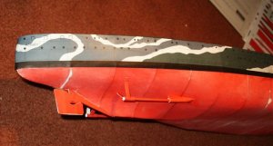

jkrenzer

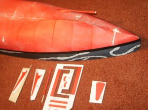

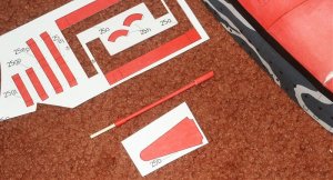

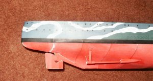

Another 1.5 hrs Thursday evening, some work on the two shafts and the rudder. The kitchen got an hour of touch up spackle.
I rolled the shafts over wooden dowels.
This hull has been a pleasure so far and I will paint it while the kitchen paint dries this weekend.
We are finally suppose to warm up in the northeast US this weekend. We are just finishing a 2 week stretch of 20 deg F below average temps. I am looking foward to some warmth finally.

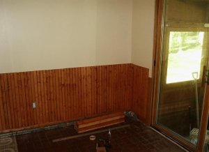

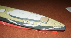

jkrenzer
Update on the projects;
Kitchen - 70 hrs, Rodney 22 hrs

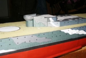

The Kitchen is proceeding, the cabinets will leave the factory Monday and the preperation is almost complete. The wall opposite with no cabinetry has the waynescoat (what ever they call it) in stalled. Spent the last weekend stripping, sanding, and refinishing the window over the sink.

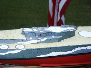

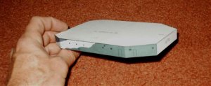

While the stain and then the varnish were drying i got some fun work done on HMS Rodney. The lower superstructure is built in 4 parts, 3 of which are framed in. Those three are completed and the fit was perfect.
Fly Models in all their old ways just seem to look the best when done. This model is not perfect in fit but the hull is fairly smooth and the upper works seems to fit great. The walls have no stretch or sags. the deck is flat smooth. I still believe Fly has it right, just enough detail to look great but not so much to be obviously over done like some of the newer GPM kits.

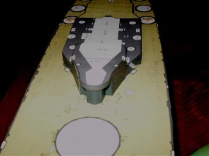

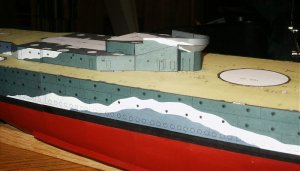

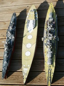

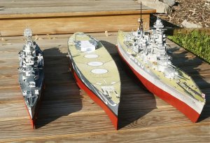

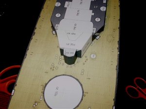

jkrenzer

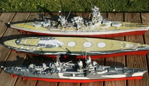

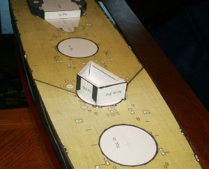

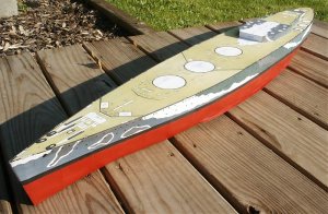

I took a few more shots since we actually have some sun here in central NY. At this point I laminated the superstructure 1st deck level and painted the hull. I tried to get a contrast showing the decks. I the last group of photos I placed my other 2 Fly models USS Portland and IJN Nagato for comparison.
The kitchen is getting close to assembly. The cabinets should arrive late this week or early next. Once they are here I will likely stop working on Rodney all together.
Tonight I will work on the foward superstructure as it has no internal frame. The superstructure is built in segments 31-34. 31 is the last to be installed. The deck is laminated after installing 32-34 because 2 pieces cover 3 and the seams are not collinear.

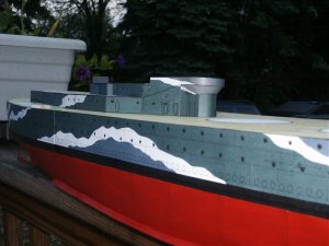

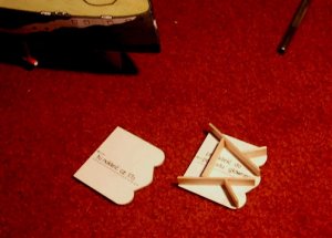

This is the last of Monday nights work. The foward superstructure is strickly old school. No reinforcement possible and none tried. I used the built in tabs, a little oversized due to the fold width adds a bit to the length. Also the upper surface is a little wavy.
The cabinets are confirmed for delivery Friday so Rodney will likely sit more than not for a while.

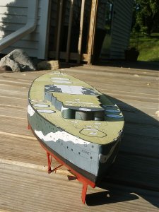

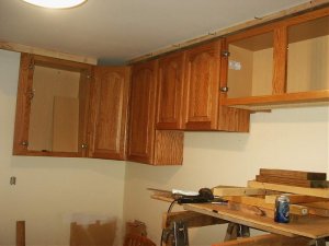

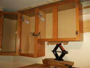

jkrenzer
Latest installment.

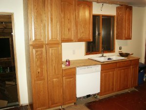

The cabinets arrived Friday. Thursday night I got a little further on
Rodney. The second deck is done framing. This is a fun model and I can't wait to get to it more once I am done cabinet hanging.

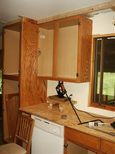

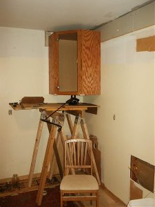

I spent all day Saturday and Sunday finishing the kitchen prep. Started installing cabinets Sunday, like a big model but easier. The stove/range and dishwasher will not be delivered for a few days.
I used the jack from the car to elevated and hold the upper cabinets in place while squarring and fastening the cabinet. My brother in law suggested the jack. I made extra tall saw horses then hoisted the cabinets onto the jack and eased them into place.

They look great. You can really tell a difference in the three ships when looking at them bow on. From they're starboard sides, the US cruiser doesn't appear to be all that much smaller.

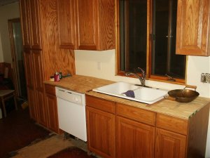

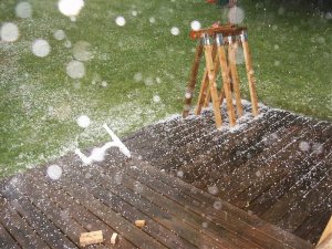

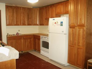

The light is begining to appear at the end of the tunnel. I finished the cabinets. Next step is the sub floor. I also managed a few minor additions to Rodney and got to witness 2 terrific hail storms on Monday, a real rarity for central NY.
