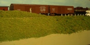

Pooh Bah
My current layout uses foam insulation, painted then covered with scenic materials.
I've previously used paper towels dipped in plaster then draped over a form. (called hardshell). This was finished off with zip texturing. The form can be crumpled newspapers or strips of cardboard fastened together. The old method was screen or chicken wire over wood supports, then plaster added.
This bit is done with extruded polystyrene foam cut with hot wire, painted with latex and covered with Woodland Scenics turf (and other things).

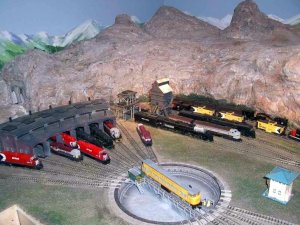

Denyons
What does everyone use to make hills and mountains?
Hi Mike, I use the blue or Pink styrafoam layered together and glued with PL400 caulking compound. I then shape with a hot knife to my preferance and do a hard shell of paper towels soaked in a thinned plaster.
I then did plaster rock moulds and finally sprayed the wole mountain with a watered down India Ink solution. This gives the rocks a nice grey colour.
I then purchased a few Acryilic browns and greys from the dollar store and watered them down to brush over until I liked the look.
The nice thing about this method is that I can even remove the mountain if needed. You can disguise the edges with shrubbery or trees.
Dennis
