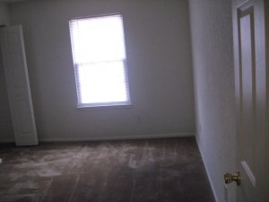

Suddenly, My cramped space has gone away: I have an entire bedroom to use, that needs NOTHING else but trains. The room is about 9x11. I can post pictures later.
My question: Should I Plan one full layout for the room, or stick with the smaller plans I've done before as modules connected together?

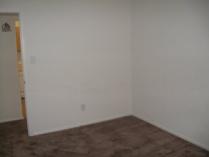

The room is roughly 9x12
Attached are a couple pictures of the room, from the door and from an interior corner.
lights have to be added (No overhead light)

my initial idea is a reverse F-shaped layout using my existing 2.5x4.5 and 3 doors
the Doors will run along the walls in the first picture, in basically this shape:
_ _ |
the small layout (which has an interchange track) will sit at the juncture of the two doors making the plan look basically like this:
_i_|
Planned height of the base is between 30 and 36", and the trains will be operated from a seated position, cause I'm lazy like that :)
This leaves the other corner (the second picture) for a small HO layout that will always be July, 1976. (a small place to run my old Athearn Seaboard Coast Line #1776.
