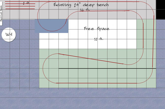

I've got half the garage, but with some limitations. As you can see on the plan at one end I have to have access to the electrical panels and there is a water heater. There is a 24" bench that runs the full length of the garage and about 16feet of it is available for use as part of the layout. There is storage underneath it which must be retained.
Now for the tricky part. I live in Hurricaine Country. In case of a major storm the layout has to move into the house to make room for the second car in the garage. The part on the bench will be permanant. If I add the area in green as the layout I only have the one spot where things would need to be joined. I could also split the rest of the green area in two somewhere to make it fit into the house. That dark line down the middle is a scene divider.
In terms of a plan I love what Nazgul has been doing and thought about a variation of that, but I don't have access all around since that bench is against the wall so it would put parts of the layout out of reach. Recently I've been looking at Cliff Powers layout and even though it's way bigger that I have room for (or skill for! I'm new to this) most of it is on 24" deep benchwork. I could do something like that. We're thinking rolling hills, not mountains and a rural landscape. Some elevation changes, continuous running with some switching and a yard (down near the electrical boxes I think. The only equipment I have is a beautiful Pennsylvania Railroad pre-war K4 Pacific. Any ideas? Input? (HO scale by the way)
Thanks, Christina

I have 48" in the wide green section and there is enough room to play with that I could add a few inches if I need to. I was thinking continuous running in that area. It's 4x14 and the aisle is 3 ft. wide, so I could borrow a little bit from there if I need it.
I originally drew this plan (simplified with no spurs ar sidings and I'd curve the track some probably) using 18" radius. But then I thought if I keep the continuous running to the green area I can do something interesting there and I can broaden the table at the end near the water heater probably by a foot if I need to (to five feet). I could also cut off the angles inside the aisle in the base of the 'u' to give me a little more room there. I have access to the far right side from both sides so I was thinking the return track there going back to the grey bench can be hidden in a tunnel. I alse have access to the green area from both sides. It's only along the top that I have single side access.

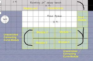

If portability is important, you definitely want to build modular. Standard modular building practices would be to use 2ft. x 4ft. modules. I suspect you will most likely need to break down the layout on average 3 times a year (that's the average times per year the southeast gets hit/sideswiped by hurricanes, right?).
This would be the ideal modular layout in your situation I think:

You can scenick the connecting curve modules if you want.. Most of us in modular clubs don't bother because they simply connect one member's modules to another.. But for your own application yea nothing wrong with scenicking the curve connects.
As far as moving a layout around goes, the reason why modular clubs usually go with 2x4s is because that's the largest size one can move easily. Any bigger than that, it's very difficult to manhandle.
Even a blank sheet of 4x8 plywood requires at least 2 people to move around, and even then one can only get that through a door with difficulty, and seldom without bumps here and there. If a piece of 4x8 plywood has been scenicked, forget it. Move it through a door and you will invariably get some damage to the scenery.
There will be seams where modules join, but you can disguise them reasonably well (like the Fundy Northern I linked to earlier).
Other options if you want a big solid layout:
- Put it on a rotating frame. When not in use, rotate it into a vertical position for storage. There have been many articles over the years in Model Railroader and other magazines on how to do this.
- Put it on winches and pulleys, and lift it up and suspend it from the garage ceiling and park your car underneath..
All these will still involve seams though.
Good luck whatever you choose! :thumb:
