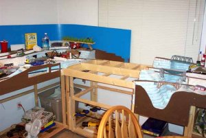

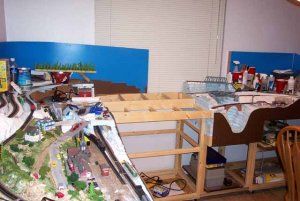

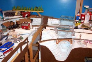

Hokey dokey... well, as I mentioned somewhere before, I got permission to claim another sacred 3' for the railroad. Trouble was, I did not want to just add it onto an end so I cut it down the middle and added it in. Kinda messy, sorry. Cleaning up is low on the priorities list. Now I just have to bring the middle section back up to par with the rest.
