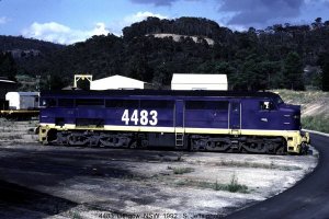

Hello.
I have been away for awhile. I know this topic has been hammered to death but I really need the help of everybody on this one. I recently purchased an HO scale New South Wales Class 44 in the Candy Stripe scheme. I would like to know what is the best way of removing paint from Lima models, as I want to paint this model into the scheme of my freelanced railway. I am told Lima may use acrylic paint. I really want this to come off with out a hassle because these engines are very hard to find it took my 15 years to find the one I have. This is what a Class 44 or ALCO DL500C looks like.
Thank you very much,
Jorge

I have many Australian Lima locos. I think you'll find the main prob is the candy stripes. The actual body is coloured.
