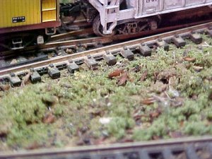

Drew1125
Hi Jesper!
If you mix the textures, like the others here have mentioned, it gives you a much more realistic look (as opposed to the "Golf Course Central" that Vic mentioned :D )
Here's what I do...
I start with the earth-colored latex paint, then I add dirt that I've sifted through a metal window screen, then I add some ground foam, some more dirt, & some "debris"...i.e. twigs, pieces of scrap styrene, etc...
It comes out looking something like this...
