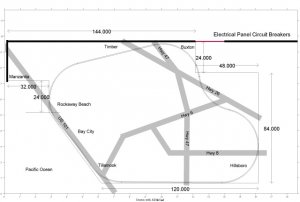

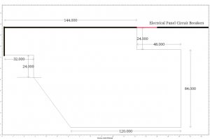

Here is the space that I can use. The heavy black lines are the only real walls (no access), the lighter lines represent the maximum space I can use (full access). Iv tried a few bench work options, but Im in a rut. My engines and stock is mostly modern era, though not current.
Throw out any ideas!
Duck unders, lift outs, hinges etc. anything goes!!!
A theam would be a great place to start!

Hi Dansco. You seem to have a main area about 7 feet by 13 feet with a long rectangle behind it; or 9 feet by 13 with a notch and a lump.
Steam, diesel or both? The bit at the top left could hold a small turntable with tracks around it. Or the back area could be a yard of sorts with engine facilities in the top right corner.
I'd probably go for a basic circular shape -- you could get 2 to4 feet wide with your access (inside + outside) except at the back. Now I'd try to put the main running lines as far out as possible to get the widest curves, and add the interesting bits inside, where they'll be more accessible. Can the lower left diagonal border be fudged any to get a curve? If not, you can fit a bit of siding into the corners.
You could get curves of around 36" radius for your main lines.
If you're looking for an older freight operation (40' cars), you could push it down to 24" radius. A wye across the front (bottom) face would let you put a yard or station across the middle of the space -- possible raised over the rear benchwork. Or put the wye on the back wall and have a nice visible station at the front.

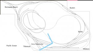

Here is my latest design, a work in progress.
The "hidden" track is the "loop through." I believe the proto is point to point, but for NASCAR set (my 5 yr old son) a loop is a must. The long spur along the front gives me a place to build up trains, sort of an mini staging... its not realy a tunnel, but sits 4" lower than the rest of the layout. So you get a sense of it not being part of the scene.
The blue line between Tillamook and Hillsboro yards is a divider.
Id like to try and fit a small independent that explores the coast range.. perhaps someone revitalzied an old loging train for a "dude ranch" type set up...
Please spot any obvious problems...

May I suggest a scene divider or a mirror to give the appearance of longer sidings in the lower left corner where the Tillamook and Hillsboro yards come together. Also, those two stub tracks beyond the switches at the left end of the Hillsboro yard look pretty short.

grewsome: The yard is at the end of a siding. one way in one way out. Ill post a better pic that sould clear it up..
Jim: If you look close theres a thin blue line exactly where you sugest that represents scene divider. Im trying to get some more siding in the hillsboro yard, without going to far into the rest of the layout, but its not going well.

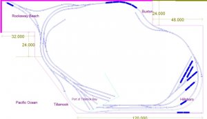

Changes:
  • Changed Point to point cities to be more in line with the proto "Port of Tillamook Bay Rail Road"
  • Improved yard along front edge
  • Added "Staging" in and out tracks and reverse loop.
  • Added mountain tour loop (not proto) but could be...
