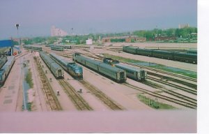

The attached photo shows samples of most of VIA's current loco and coach types (except Renaissance and Canadian). I hope you can see them OK -- the film was pretty old. This was at Willowbrook yard in Toronto (Mimico).
On the right are the ex-Waterloo-St. Jacobs train and some RDCs.

When was this one taken? I see at least two P42's in this pic, plus and FP40 tucked in behind a single LRC car... aside from that one, the rest of these look to be the Budd Cars, mostly likely in the HEP-2 scheme. Then again, the train on the far right may be the Renaissance cars, but I can't tell from the pic.
Looks like the trains in the middle would be set up as 1 Via1 Club car, and 3 regular coaches following. Basically four coaches, with one with different markings and a nicely done up interior.

John: In the original photo, the 2 trainsets headed away from us look to be Budd stainless behind F40s. The P42s all seem to be trailing LRC coaches. The long trainset in the distance may be Renaissance -- the ends look different.

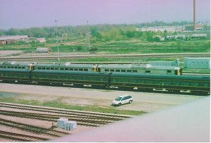

And the one on the right is all in CNR green and black -- the ex tourist train. see attached.
Date was June 2003.
