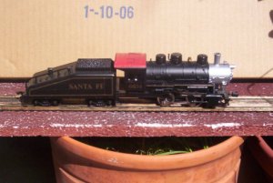

1st Q--------DOES ANYONE KNOW WHAT YEAR OR YEARS...THIS IS (I THINK ITS A BALDWIN) . the pic below is the the unit i got on sale. its a Model Power Santa Fe 0-4-0. im going to model late 1800s to 1906 or so HO main line & Narow Gauge log/ore busness line. so i want to know if it will fit in..... my NG line will be HOn30/Ncheater.... i think....lol

Dedicated 0-X-0 yard switchers were not generally built until the 1890s. Before that, the older road engines were generally used for switching duty. Also, the model shown has piston valves. Slide valves were standard until at least 1895 also. My guess is the model has no specific prototype but is reasonably typical of small switchers built 1905-1915. It could easily have served 30 years after being built. Steam engines were often rebuilt and modernized during the rebuilding. Most HO models of older prototypes are actually models of the modernized version - a prime example is the Bachmann Spectrum 4-6-0. True as-built pre-1900 locomotives are very difficult to find in any scale outside of brass. Just before WW1, 0-6-0s began to dominate new switcher orders. The extra sand dome was a Santa Fe character trait, but was not limited to Santa Fe.
