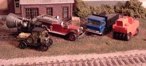

I try to build off of what is readily available, scratchbuilding only when I have to. The three trucks to the left came from Model Power hearses and a fire truck, extensively modified with kibbles and bits from the scrap box. The blue truck is a cheap party favor with a scratchbuilt stake body. The road compacter is completely scratchbuilt from sheet styrene and scrap box details.

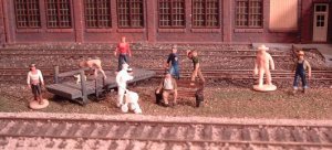

My LPBs come from...well, er...I just buy large lots of unpainted figures and think of them as merely a large collection of body parts to be removed and reassembled at my will and desire. Bambi on the left started our life as a Plasticville LPB minister, now with repositioned arms, an enhanced chest, navel and pants carved to look like boots. Her sister on the peir started out as a Plasticville brakeman, cut at the torso, reattached with limbs reshaped and features enhanced with a putty I make by disolving sprues into liquid styrene cement. This same putty could be used to help you get those curving lines of late 30s, early 40s cars. The figures in the center show how they share common features that were modified to suit. To the right you'll see how I got a figure by simply carving off details that don't fit the era I model.
