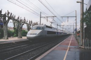

Graham,
Nice shot - how about posting it to my TGV thread in the new international section?
I had seen the Sommerfeld stuff before. It looks nice but you have to be sitting down when you start adding the prices up :eek:

Hi terry,
Thanks for the comments, I'll post the pic shortly.
