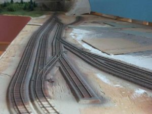

Here is an example of my handlaid track, it's code 40 N scale on PC ties.
There are more pictures on my webshot account.

jkristia, your hand laid track looks real good I'm just wondering how long did it take you to get that far? and how much money do you think you saved?

Belg, I didn't do it to save money, but because I like the look of C40 rail better than the Atlas C55 track that I'm replacing. I think that each 3 foot section of track is about $2.50 (rail, wood ties and PC ties), where ME 3' C40 flex track is about $4, so of course there is a saving compared to commercial C40 track, but not compared to Atlas C55 track. The big saving is with the turnouts. I use less than one length of a 3' rail (1$) to build a turnout, so I would guess that a turnout is probably less than $2, so there you have the big saving. But as I said, I didn't do it because of the saving, but because I like it, to build it and the look of it.
But yes, It does take much longer than if you are using commercial trackl. I would guess that it took me more than a month, maybe closer to 2, from I started this section until I had all the track down (maybe a total of 20-25 hours or so). A turnout takes 2-3 hours if you include the time it takes to cut and glue the ties. Once the ties are down, it takes less than 2 hours to actually build it (cut, file, shape and solder the rails), but I don't really count the hours if I'm enjoying what I'm doing...
