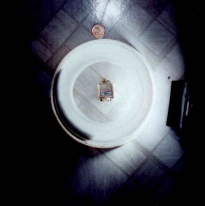

This is my home made ring light for macro (photogrtaphed with a 70mm lense to show how the light works; note the "shamus penny" :D )
