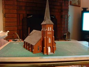

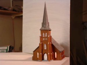

I followed the same steps in building this church so didn't want to bore you with the same old same old. I decided to call the town on theNtrak corner module Griswold. This is the same module that the now Griswold CP station is on.
The first view shows the church still on my building table.

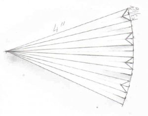

Wow!!! I would have prefered a series of progressive photo's with commentary. How did you get the angles and lengths for the steeple roof? Did you cut and fit or did you use the intersection and developement method? You never cease to amaze me. Thank you for another terrific model. :thumb:

Bud I drew the design for the steeple right onto cerealboard but have drawn it on paper to show how I did it. It has 8 segments.
I cut out the outline then scribed the lines with a couple of cuts to make bending easy. Just bend along the lines, glue the edges together and you have a steeple. The angled cutouts on the 4 bottoms allow the steeple to sit on the 4 sided roof on the top of the tower.

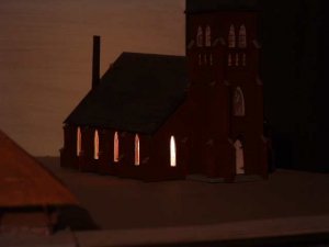

Your church is another wonderful example showing your talents. Of course you can't go back and rebuild it. But one question: Could you explain how you created the stained glass windows?

The stained glass windows didn't turn out as good as I hoped they would. I did a google search for church stained glass windows and came up with more than I needed. Saved some to my HD then went and got a couple of transparencies that were made for an ink jet printer. Printed them, cut them out and glued them in place on the inside of the wall. They were quite faint in colour and the light just about washed them out so I put tracing paper over the backs of them which diffuses the light and they look somewhat better.
