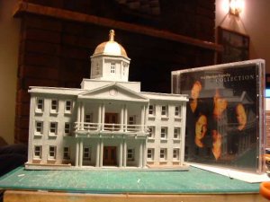

Nelson, here is a photo with the courthouse next to a CD case.
Hope this gives you what you want. In actual dimensions, it is 7 1/4 inch wide. 6 1/2 inches high to the top of the dome and 5 1/4 inches deep.
davidbross I used a protractor to give me the 60degree angles

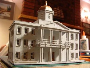

A little closer. Ready to have the lights installed and a few other details like flags and a bit of weathering.

Robin, this is just another example of your great imaginitive solutions to making it seem simple. Do you use anything to seal the joints before painting? I wondering how you will handle what seems like a small curl on the base of the structure as this is something I've had trouble with as well?

Pat I can usually get the curve out when I glue the model in place with a few weights on it. If it doesn't come out I just bring the scenery up to it and the curve disappears.

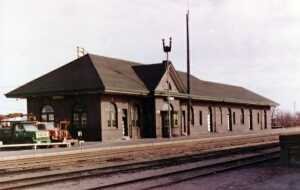

Any suggestions on scratchbuilding a train order board for the station?a working model runs around 30 bucks and i may go that way 1 day,but for now a static model will have to do.The one i am thinking about is a pole model aprox 20' tall. thanks
Don't really know what a train order board is... got a picture of a real one?

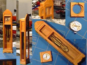

Ok Todd, here's the clock I made. At about 1/2" diameter, it's about as round as a man is tall. (For some reason, old movies where a guy is hanging off the minute hand by his suspenders comes to mind. :D ) The battery has since died, but that is precisely why I built it this way... it's an easy matter to replace it. Sorry for the picture, I tried to smoosh everything into one picture.
P.S. Robin, judging by your size comparison photo, this watch (a lady's watch) might be a bit big for your courthouse, but maybe a little kids watch would do. I would probably have it come out from above... just put part of the angled roof onto the encasement and cut a "slot" for it in the roof.
EDIT: Forgot to mention, looks like I was off by quite a bit... it's funny how the mind exaggerates when going just by memory. The clock isn't 3" high, it's about 4 and 1/2" :eek:ops: It's probably older than 2 years, too. I just make these things, I don't keep track of them. :D My wife would know better than I would.

Way cool ,and way nice. I am thinking about the proverbial clock tower in the city(love the idea of the guy hanging onto the minute hand LOL)
Duluth actually has a clock tower.Its built into the old high school(no,i am not going to scratchbuild it,it would take forever as its all stone with gargoyles and the whole enchilada) I am thinking something just a bit tamer.Old central is 2 city blocks long and 1 city block deep.the tower is about 80 feet high.It would take up most of my city area LOL
Thanks for the pics Arl :)

Thr Train order board was designed to let a train know wether it had orders.Its position denoted wether a train should stop and pick up orders, pick up orders on the fly or proceed through station.In the case of this particular station it has a double train order board as it had seperate tracks for east and west and 1 arm of the board for each.its the silver pole about 20' n height.in front of the telephone pole.

Wow, Robin! Thanks for sharing that one, too! I love seeing these models come together. It's given me the courage to try it...someday! The CD case really brought it into sharp relief how small it is. Was that the Partridge Family? :D
