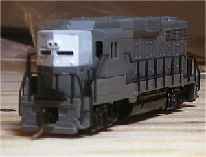

Brian Schmidt said:
It'd be much easier to mod a GP30 with a high nose than to make anything else with a high nose into a GP30.
I agree. The short high-hood of a GP7 isn't even the right kind of hood for a GP30, as the GP30 and later EMD units have a "pointed" end to the hoods, instead of the "flat" end of the earlier engines. Using the tail-end of a second GP30 shell is rather straight-forward, as seen in my attachment.
---jps

Herc, LL Proto2K came out with the HH GP30 in HO. I got two of them in my beloved N&W colors 2 weekends ago with DCC and Sound. Great runners!

johnh - that's outstanding! How did you do it? Where would you get the parts and detailing pieces? Did you make the molding? I'm really not too familiar with castings and how they're created etc. Did you paint that Southern? Wow, it looks good. I can't wait for one to come out since doing it myself wouldn't be practical for me right now. What do you use for the chassis and motor - a regular GP30 low nose? I've been hoping to pick one up since my son and I got a cab ride in one restored by the North Carolina Transportation Museum. He loved the experience (even got to blow the horn as it entered the station) and I've been searching for one ever since. Do you make these GP30's? What railroad do you model?

For those who don't want to do their own kitbashing, in the past few months, I've noticed that there is one fellow who offered GP30 High Hood cab and noses (one piece) on eBay. And another fellow regularly offers complete GP30 High-Hood bodies. Search under N-scale, then "GP30", and you'll find it.
