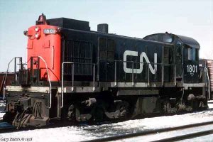

Let us know how you make out. I've often thought of doing one of these in n scale, but first I want to do a pair of RSC-24's they were used here in Bridgewater.

Rsc-24
I'm going from memory so don't quote me.
The RSC-24's were built, when CN asked for light diesels for light rail like the GMD-1's with A1A trucks. There were only 4 RSC-24's built. They were built useing prime movers that had been removed from FA units after they had proved to troublesome for passanger service, derated they seemed to serve fine. They were built on S type chassis, wth the electrical compartment moved to the short hood as CN had specified that they had to have hood both ends of cab for crew safty as these were to be used as road units on light rail, this wasn't needed in hind sight as they normaly ran double headed back to back.
One was rected in Quebec the remaining three ended up in Bridgewater Nova Scotia, which is were I live hince my interest. They were used on a brach line from the South Shore to the Valley from what I understand.
I think I can do a model useing a cut down RS-1 shell and RSC trucks. These trucks will not be correct as there trucks had the idler axle centered. I will most likely have to mill the frame if I'm to have it powered. If I do it I'll have to do two as they were used double headed, and I might need one for decoder one for motor. Don't hold your breath waiting for me to do one as there are many other things hirer on priority.
