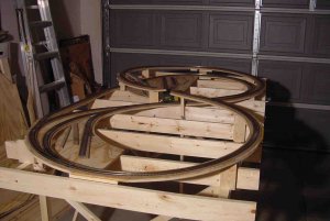

I just wanted to thank everyone for the valuable information that I have received so far. I haven't posted in a while since I have been busy buying track, researching and reading everything that I can get my hands on and building the benchwork.
Well, the benchwork is almost done with only about an hours worth of work to complete and I will be putting down the track bed this weekend. I was originally going to skip on building the benchwork and now that I have it almost completed I am glad that I decided to build it because I feel that it will save me a lot of headaches in the future. Since my track will have quite a bit of elevation changes the benchwork will make easy work of it by attaching risers to it and I will be able to easily add any rivers or lakes if I decide to.
I decided that if I was going to do this as a hobby that I was going to do it right and take my time to do it right the first time rather than fixing things later. Besides, building the benchwork has given me confidence since I have never really built anything with wood before except for some things when I was younger that were lopsided. I took my time and the benchwork is looking really good.
I will take some pictures this weekend to update on status and get ready to be asked a lot of questions moving forward on things like electrical, soldering etc...

petersd
Its taking longer than I thought but overall I am quite pleased so far. Should have the trian up and running by this weekendl.
Dave

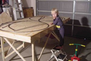

petersd
He loves trains, trucks, etc.... In fact he earned enough money to take a short trip on Amtrak this last weekend. He earns a dollar a day for being good and doing his chores and he uses it for train rides.
In fact, everyday we have to stop by a railroad crossing so that he can see the Metrolink go by. Good thing for learning the schedule.
Does anyone know a way to get schedules on freight trains. I would like for him to see more of them and since we are only a mile or so from tracks it would be nice for him to see but it is hit and miss to find them.
Dave
jkristia
Your son (I assume) looks like he can't wait to have trains running.
Nice to see another Simi Valley resident online

petersd
He is really looking forward to it. Although he does have a Life-Like track set-up in the Living Room with is about 5' x 5' so at least I am not be highly pressured to rush. He is looking forward to the layout since it has a few tunnels and bridges and he really wants crossing guards which we'll be able to have a couple. Hopefully I can get running by this weekend and from there I should have the tunnels done in a couple of weeks and its off to landscaping and kit building.
So, are you from Simi or around the area as well? We went to the train station in Santa Susana and got a kick out of the Model Railroad they have there. Believe it or not that was the first time I have seen it. My son is the one who got me hooked since I wanted to build a layout for him and when I started researching about layouts I was thouroughly impressed on what you can do. I am having a blast and if I do a good job maybe I can talk my wife into giving up the guest room to build a big layout. This layout will go in his playroom after I weather the tracks and the room is big enough to expand out another 4 to 10 feet since it is essentially the 3 rd card garage and is a long room.
Dave
